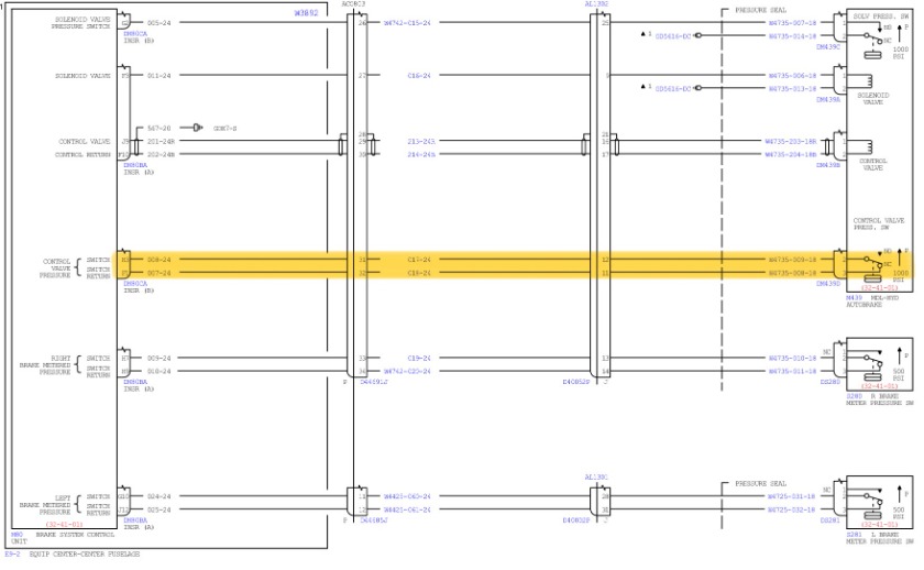

Like most Boeing, the 747 A/B hydraulic valve module has a control valve and solenoid valve. Two pressure switches are installed to monitor the operation of each valve. The maintenance message is pointing towards a failure of either the control valve solenoid or it's related pressure switch. Since the entire valve module had been previously replaced, I accomplished wiring checks between the BSCU and Control Valve Solenoid / Control Valve Px Sw.

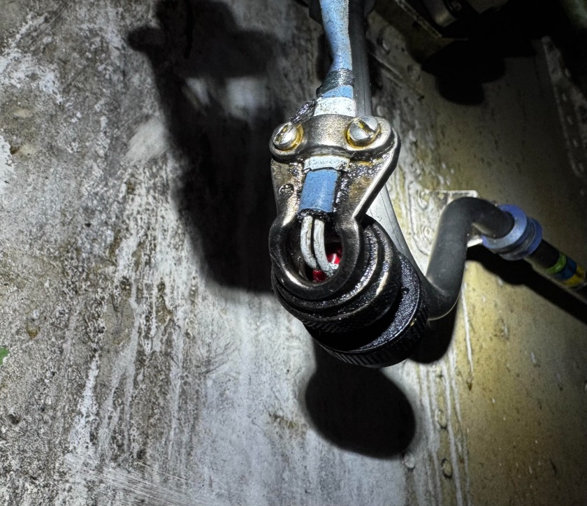

The control valve wiring checked good. The pressure switch circuit was also checking good, until I megged pins 2-3 at DM439D. Checking the prints, I noticed that pressure = open and low pressure = continuity back to BSCU. A short between the two pins would incorrectly signal "low" pressure to the BSCU even if the control valve/solenoid are fully operational. After the wires were de-pinned from the connector, the short was no longer present. Looks like hydraulic contamination resulted in the short.
4 months 3 weeks ago #1883 by Mark
Replied by Mark on topic Autobrake Issue
Great find.
Was plug replacement required?
4 months 3 weeks ago #1884 by lazyonics
Replied by lazyonics on topic Autobrake Issue
Thanks Mark. Yea, the plug had to be replaced.
