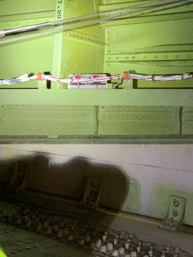

The system incorporates a couple of in-line filters used on both the sensor signal output and ground wires.
The filters are a capacitor wired to ground on one leg and an inductor wired in series. They are located in the stabilizer jackscrew area at rear of aircraft.
We had an aircraft with quite a history of the left elevator position indication being intermittent. A sensor change did not correct the issue. It turned out to be the output signal filter that was causing the problem.

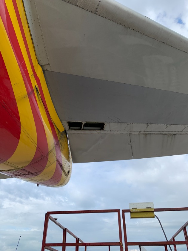

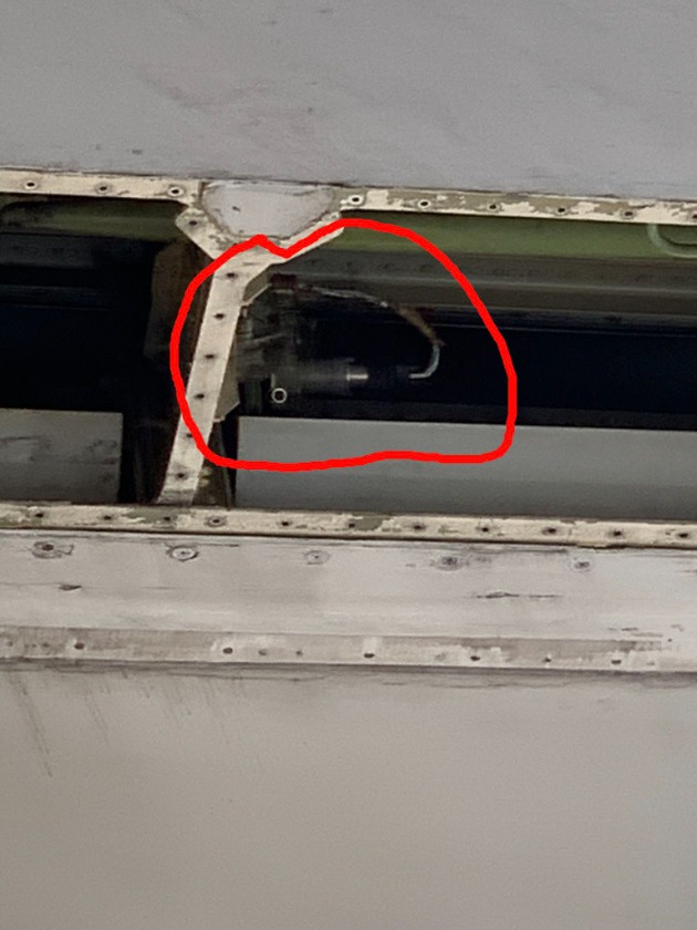

1 year 3 months ago #1797 by Mark
Location of sensor.....
Location of filters (Left sidewall directly above stabilizer).....

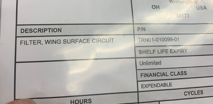

Filter part number (TRN01-010099-01).....

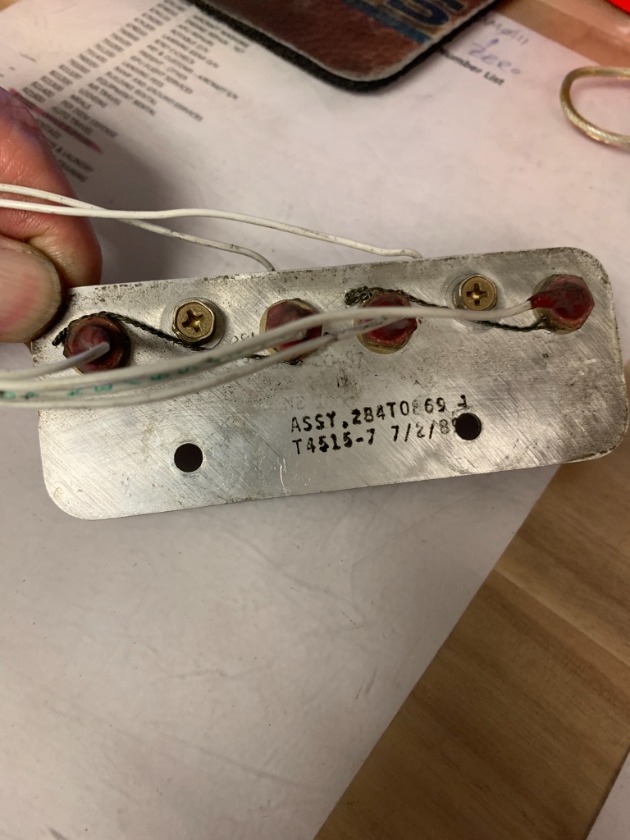

There is a complete assembly with all four filters (Part number  284T0869-1).....
