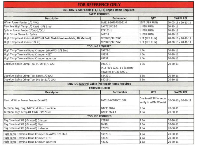

A 1/0 cable splice and terminal were needed for repair. Some part number references.

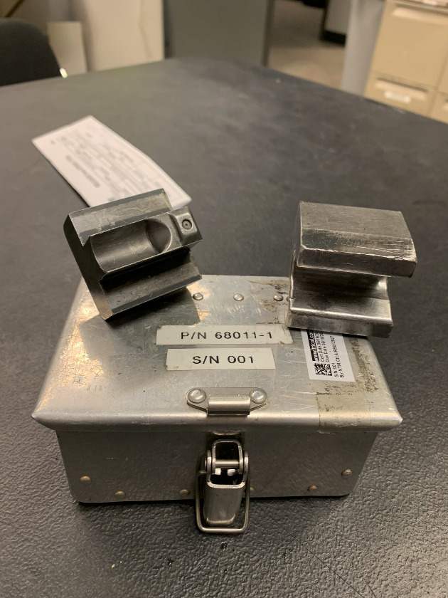

The proper dies have to be used.

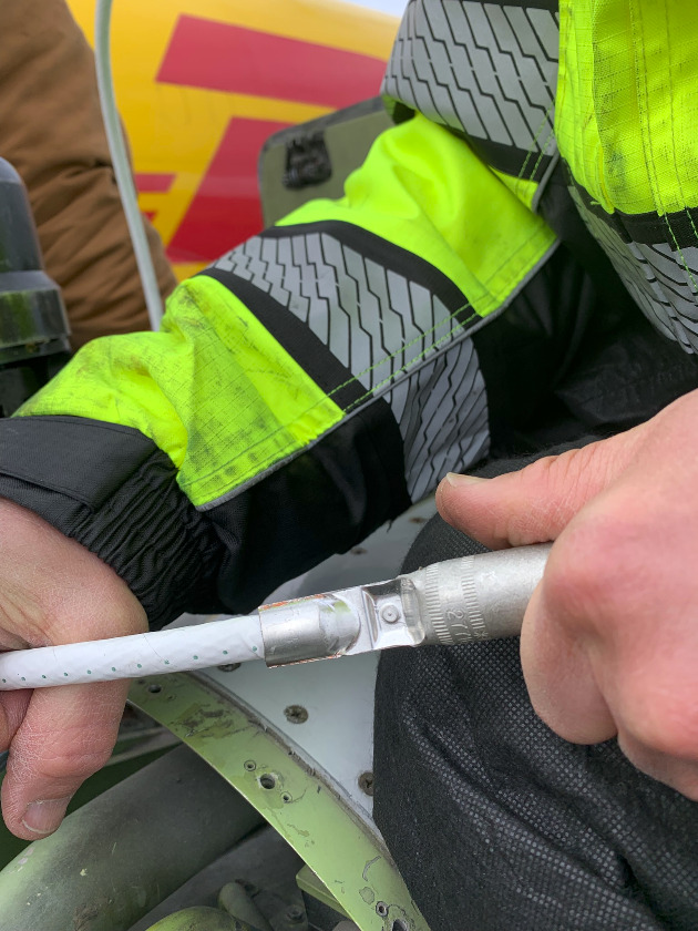

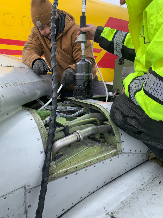

8 months 4 weeks ago - 8 months 4 weeks ago #1851 by Mark
New repair....
Splice of wire at top of pylon with hydraulic crimper.
Proper die for our wire (1/0).
Completed splice.
Reference for splices and tools.

8 months 4 weeks ago #1852 by Mark
We rejected the splice shown above.
The start of the crimp should have been at the serrated markings. We were about 1/8" of an inch off.
