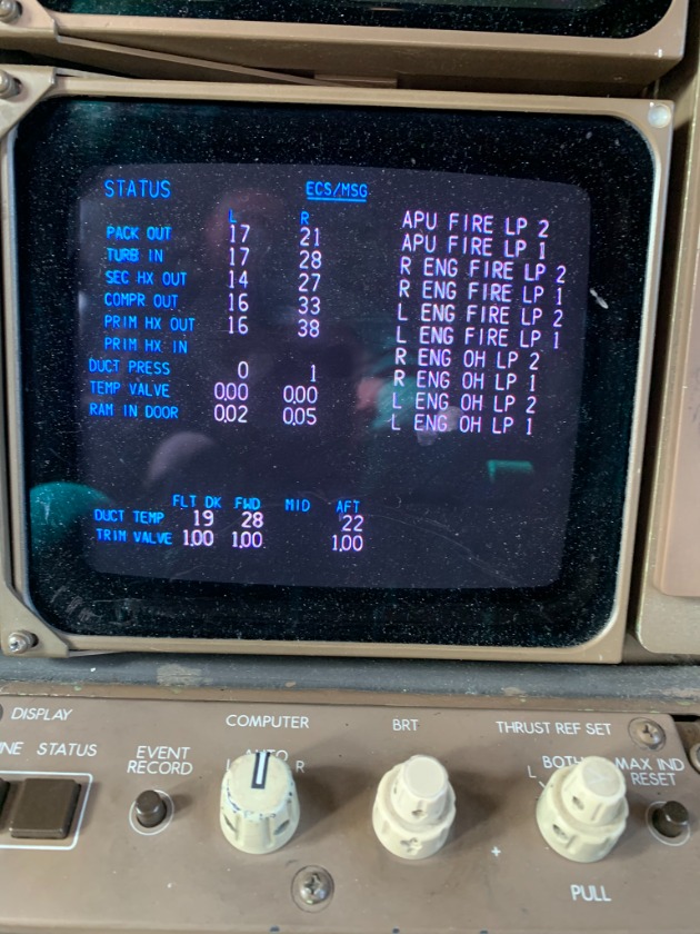

One APU FIRE LOOP, one LEFT ENGINE FIRE LOOP, one RIGHT ENGINE OVERHEAT LOOP, one LEFT WING BLEED LOOP. The second write-up was a fire system fail message on final.
When you dig into the problem, having four separate system faults at the same time seems odd. When tested, all of them passed..... meaning no actual loops were bad.

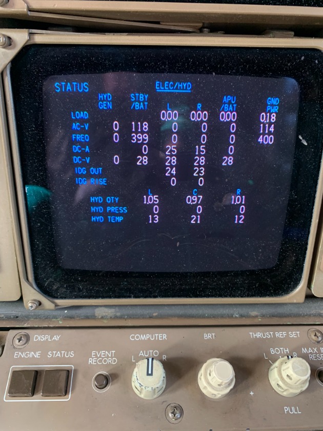

We compared DC voltage drop and recovery between the left and right T/R's during power input swaps. The right voltage dropped lower and took longer to recover. (Really hard to tell when everything happens in under a second.)

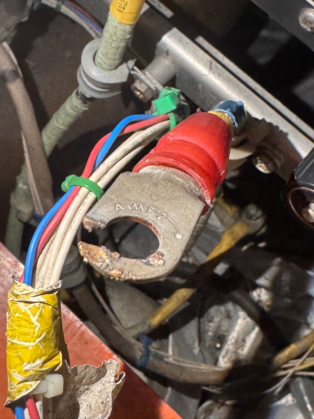

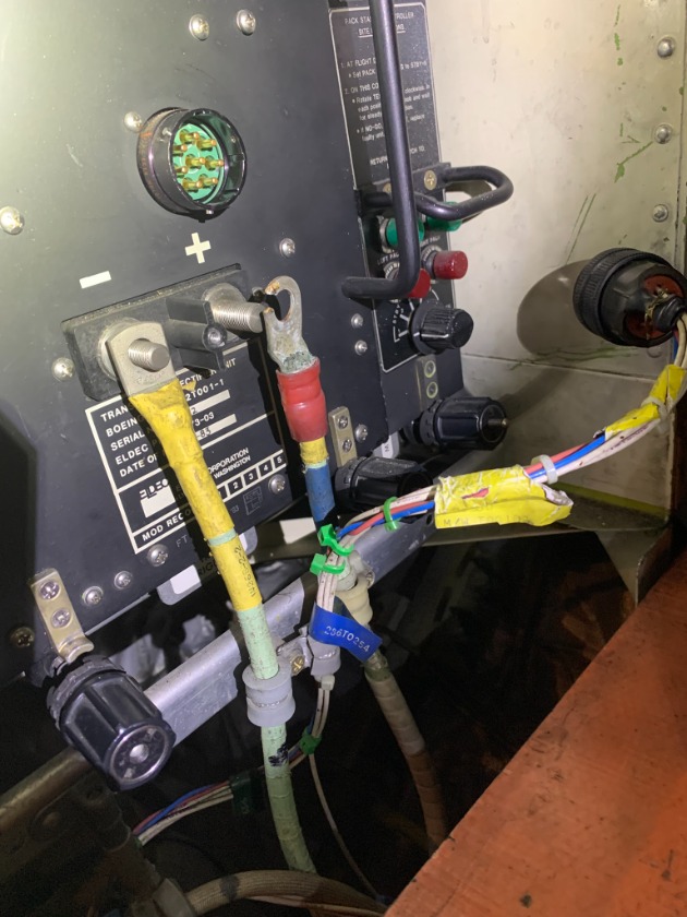

So..... when we went to replace the T/R....
Lug nut not fully tightened..... and a burned terminal.
