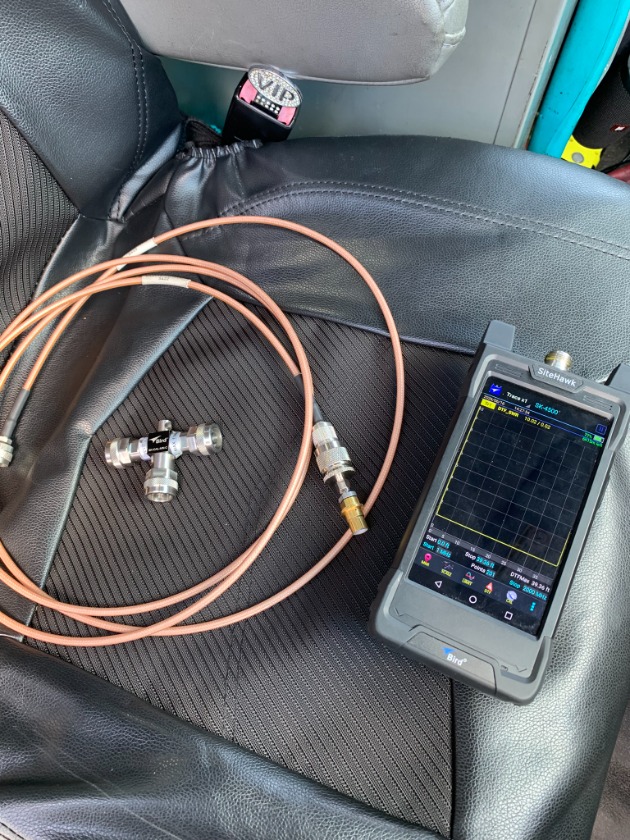

Site Hawk with calibration "T", cable, and rack adapter.

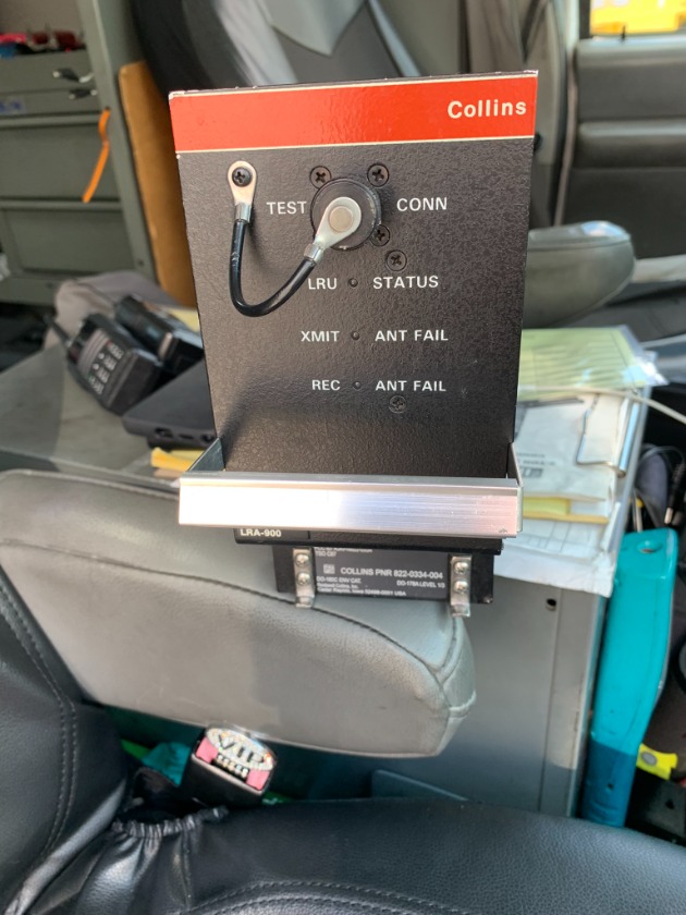

Removed Radio Altimeter unit (suspected problem with either the transmit or receive antennas).

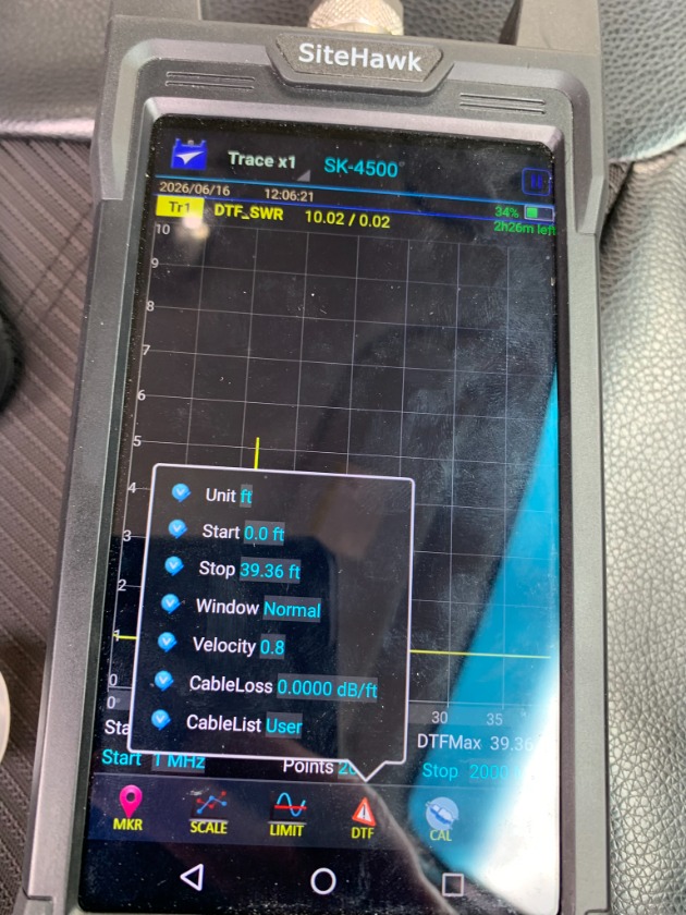

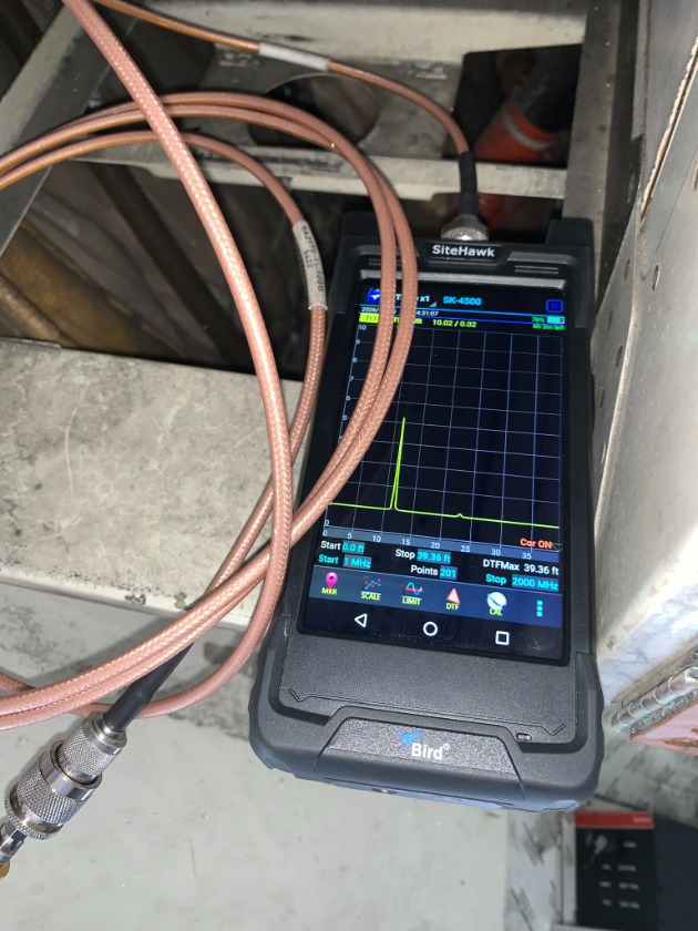

Basic set-up for DTF-SWR readings.

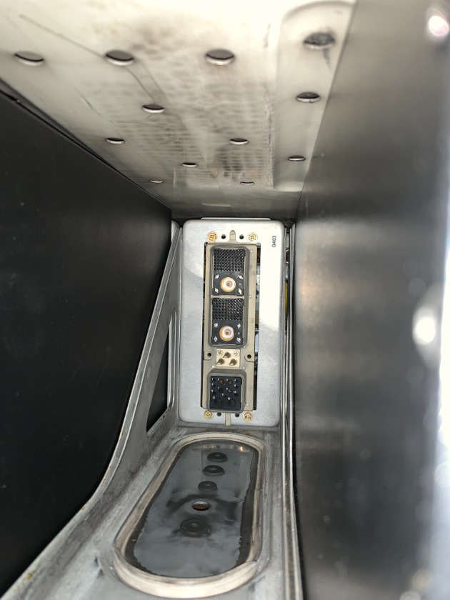

Display with adapter not connected in rack. The peak shown would be the end of the test cable and attached adapter.

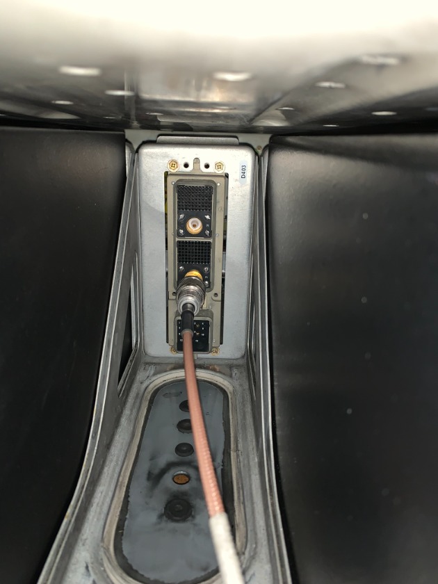

Connection in rack.

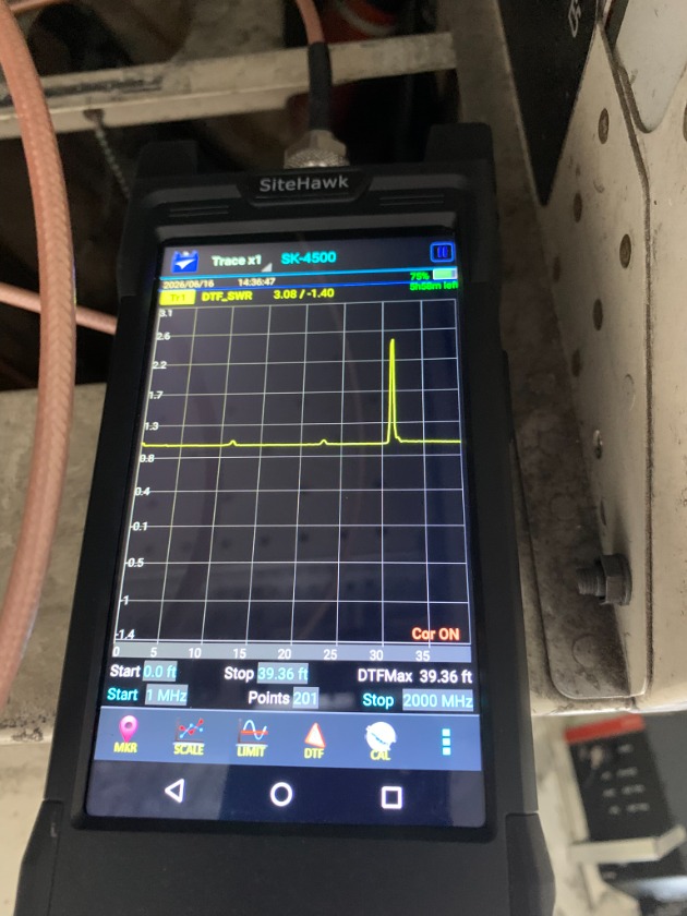

Display of cable run to antenna. The first small blip on the left is the cable to rack connection.

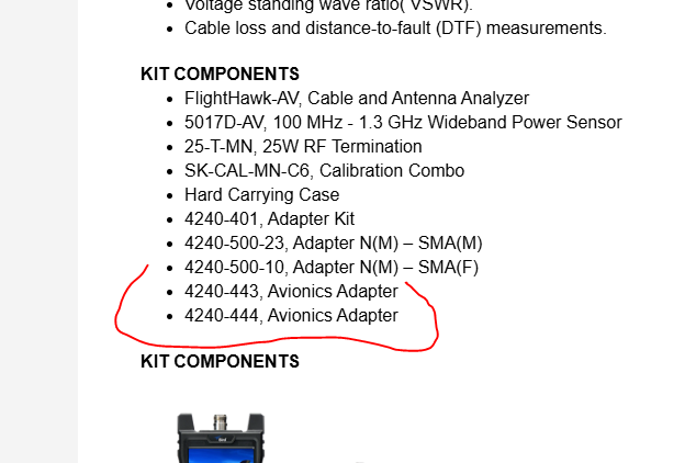

The adapters needed. Radio Alts and TCAS use the larger. Comms, Sats, and Navs use the smaller (4240-444).
