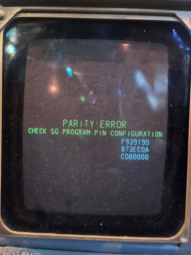

Do you have any idea on what following message on PFD mean?:
parity error
check the SG program pin configuration
F93919D
873EC0A
C080000

One of the program pins is missing or you have a broken wire from one of those pins.
Parity wires are either hooked to each other or to ground.
If you have a correct wiring print, those wires can be checked fairly quickly with a ohm meter.
This wiring issue could be at the display or Symbol Generator Unit. Switching to the alternate SGU should help you out. If the fault goes away.... your issue is with the original (on-side) SGU. If the problem stays.... then look at the display plug pins or wiring.

Program pins are a set of pins that are attached together. They tell the box such things as "what type of aircraft am I installed on" - " I should be looking for 3 IRS inputs" - "what radio altimeter type inputs do I receive" - "what my outputs should be".....
Aircraft computers can be installed on numerous aircraft types. Each box can have numerous inputs and outputs.
Program pins "tell" the box "how" to work on the aircraft type it's installed on.

The email you sent shows that the SGU's use "odd" parity.
What's that is telling you is the total number of jumpers is 3,5,7,9,11,13,15..... odd numbers.
If you had 9 and a wire broke.... you now have 8. The box sees an even number of jumpers and throws a fault.
Actually, one of the parity pins tells the box if it's looking for a odd or even number.
